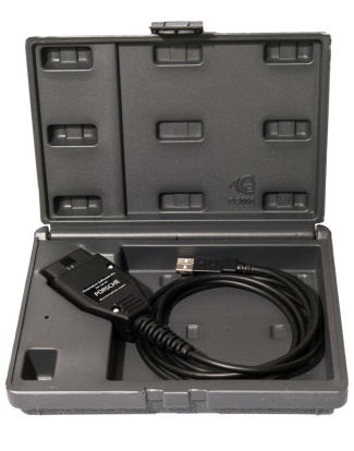

Well I just got my new Durametric enthusiast kit.
Plugged it in and got this:
