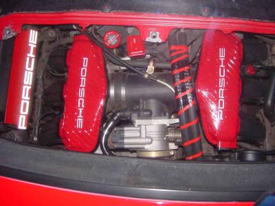

It depends how clean and careful you want to be, I cleaned my motor with a brush and warm tsp.
I ended up with this as an end product. I have to do more, but have other things pending.
Nice - do you have the plastic (see-through) engine cover to go with that?
