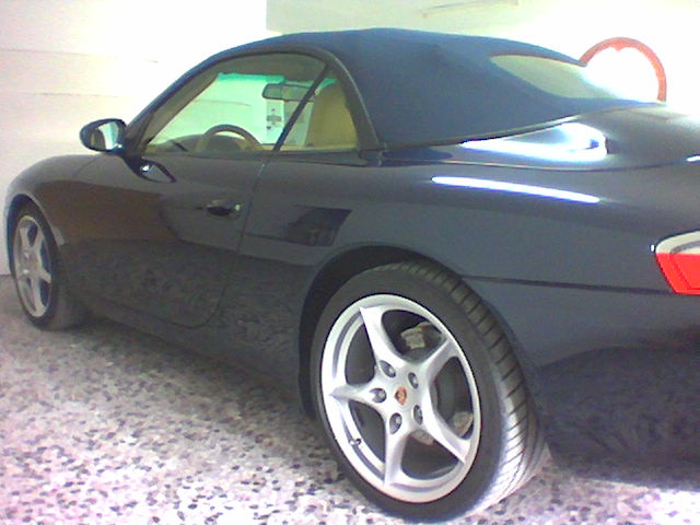

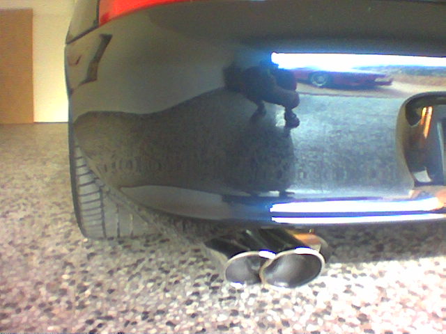

I like your car. I too was toying with the idea of 5mm spacers but dont know whether theymake the car look any different.
Could you post a pic of the back of your cab so we can see how much diffrence these make to the stance?
Netrophile,
Thanks. I like to modify the stock car to feel it more personal, but in a way that does not introduce drastic changes..you know what I mean, and always with original Porsche parts, never aftermarket.
Up to now I have done the following:
1. RoW 030 suspension
2. PSE
3. Wheel spacers
4. Exhaust tips ( from Porsche)
I am thinking in 3 mods more:
1. GT3 seats ( which I think are a must for hard driving )
2. Third radiator
3. Turbo brakes
Here is a pic from behind. The looks of the car changes very little with the spacers, BUT when you look at it, it does change. It feels diferent IMO
