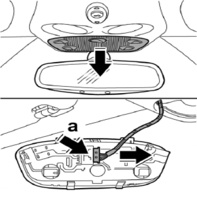

Anyone knows how to remove the roof console ? I'm referring to the plastic curved console on the roof, above the rear mirror, containing the interior lights and the sunroof button.
I think that I must remove the lights first, then some screw should be found here. True ?

But how to remove the whole trim panel ? I need to do some work here and I want pull of all the console...

If you have homelink,you have to carefully pop out the 2 outer buttons to get to the screws.
the buttons come apart easily so be sure you remove the entire button assembly, not just the top of the button.
