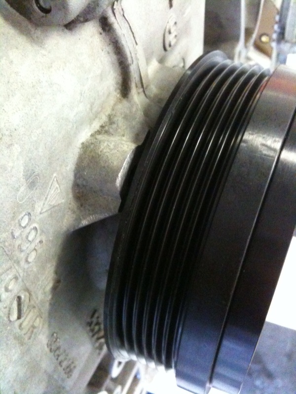

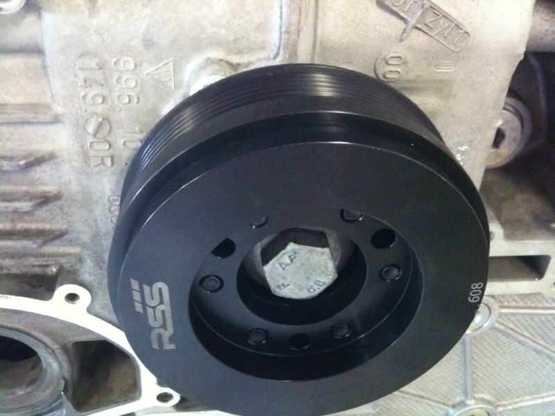

I'm sorry I didn't clarify previously, this is the underdrive pulley, from RSS, designed for the M97 3.8. As shown, once you give the boss a haircut, and use the longer bolt, it fits great. I would like to think the addition of harmonic damping is a good thing for all of these motors.
OK I have to ask this. Why? Do you think that this will improve the performance, longevity or something on a 3.4 or 3.6?
If it adds a vibration dampener (lacking in the OEM due to internal balancing), it would help prevent harmonics that can cause rotating part failures.
