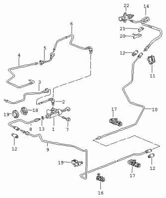

My next question (and I will ask the parts guy as well), is what do I do? Is there a line repair kit or do I just replace the line?

Sounds like item 10 (996 423 113 05) in the image below. If it is further forward then it is item 9 (996 423 109 10). Each line is about $75 - $85 each (retail).
Thanks Loren, the diagram helps very much. I think you are right that it is item 10.

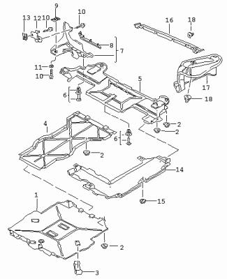

Do you know the partnumber for the rear - most plastic belly pan?
Are you talking about item 5 (996 504 129 01)? Also, don't forget to look for missing plastic rivets (item 6) and plastic nuts (item 2).
Yes Loren, you nailed it again :)

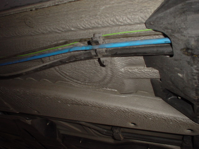

Well here are a couple of photos I snapped this evening. The first shows the leak/squirt when the line has some pressure. Also note the line is crushed, either caused by the car bottoming out or possibly a misplaced jack.

That is right the line is NOT plastic. It just looks like it might be. It is metal with a blue vinal coating; it has what look like brass fittings on either end. Seems pretty heave duty to me. I removed the leaking section of clutch line at lunch. Unfortunately no parts places that I have contacted stock the replacement so I will have to wait a week before I can drive my 996 again :(
