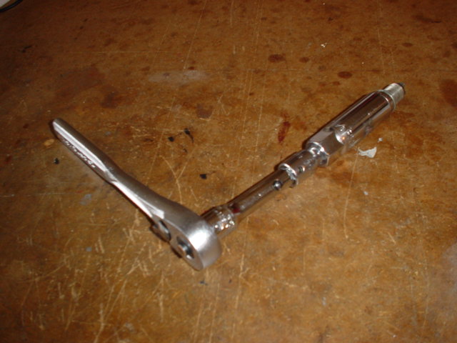

I have just changed the spark plugs on my '97. Peter at Stevens Creek did not recommend the 4 tip (bosch). I used the 2 tip from Bosche ($3.99 at AutoZone). I could not find the Beru one.
You will need 2 tools from snap on and a torque wrench
1. S9706KA Sparl Plug Socket $26.79
2. Fxw4 extension (4 inch) $21.50
3. torque wrench ~$75 at orchard (Craftsman)

You spent that much money on a socket and ratchet to take out spark plugs.
Did you torque your sparkplugs, if so be careful doing that, it is not an exact science. The crush ring is something you need to feel and not torque. You have no idea how stable your threads are, so torquing your sparkplugs could cost you!!!
I am sorry but for $15.00 you could do the same thing, the only helper I have seen [bought] are the T handled allen wrenches [harbor freight.] also maybe a couple 3/8 allen sockets.
The extension either flexible or wobble would also help, but you can make do without it.

I have used my trusty Craftsman spark plug socket, extension, and ratched tools. Did not need to buy special tools for the Box.
