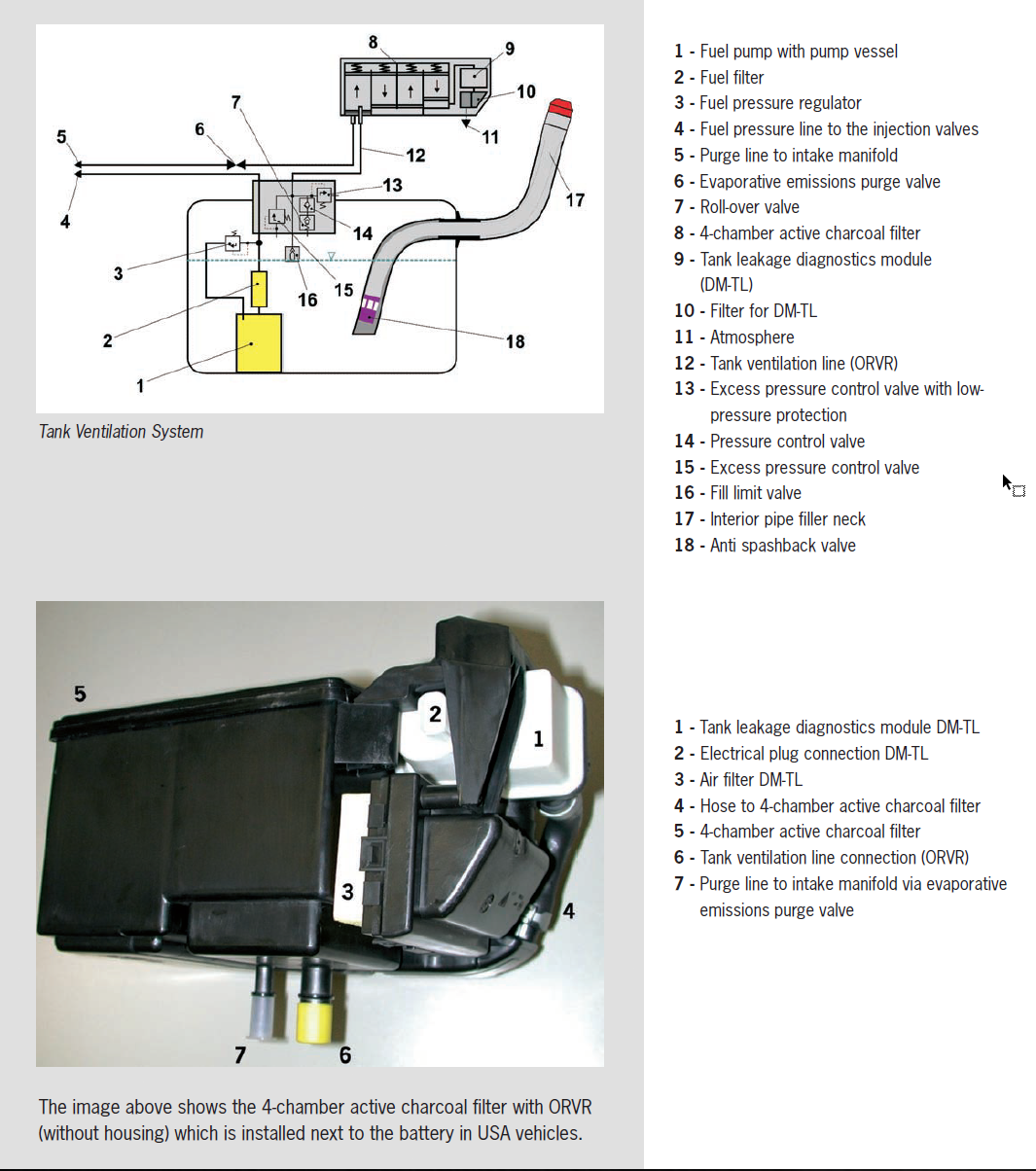

Where is this unit located on a 2007 Cayman? I have pulled off the front right wheel liner, the frunk plastics and cannot locate it. I have a spare unit ready to fit, just need to find where to fit it!
