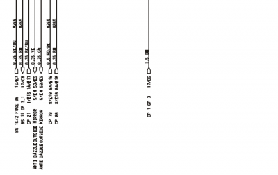

Hi- I recently installed an OEM interior self dimming mirror in a n04' Targa. this is the one that has the integrated rain sensor in the middle of the windshield mount. I need to have someone confirm the correct photocell to cover to cause the mirror to dim to confirm that it is wired correctly. There are two photo cells: 1)one on the reflective glass side & 2)one on the plastic back. When covered one causes the mirror to dim & the other one does nothing. Which one causes the mirror to dim when covered? Thanks cmg
Seriously? The one facing the windshield. Cover it and it fools the mirror into thinking it's dark out. The one in the mirror glass has to be uncovered to sense the headlights behind you in order to darken.
