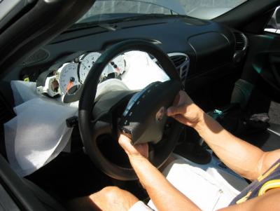

This is a pic of the test mentioned by Henry, before the cluster is put back together. Ignore the air bag thing as Ray also replaced his steering wheel with a 3 spoke at the same time the cluster faces were replaced.
