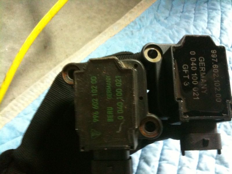

Eviebo. Here is a picture of one my plugs and a coil packs new versus old. You can see the cracked housing on one of the spark plugs. My car ran very timed taking off from 1st and 2nd gear. I had no problems at higher RPMS previous to the change. I believe this and or the cracked coil packs were the culprit. You can find quite a few helpful posts on this topic. I did the work myself and had a lot of fun doing it . Good luck post-35435-126785315291_thumb.jpgpost-35435-126785373514_thumb.jpg
