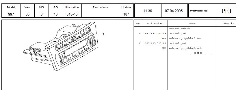

Here is a picture.
I think there is a detail instructions on removing the
radio in the 996 section. This part looks like
it slides out once you remove the consol sides.
Paul
Yep follow the instructions above to side the side panels of teh center console off. After that you will see two metal spring clips on the sides of the ac controls, press the springs down and pull the ac control head out.
