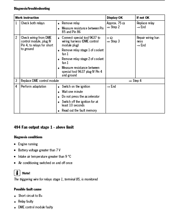

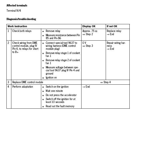

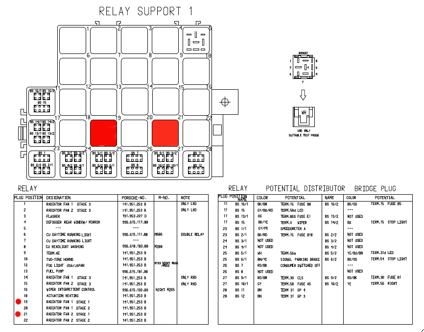

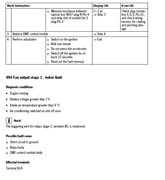

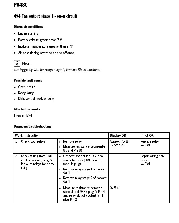

Radiator fans stage one inoperative. The cooling fans (2) in front of the car got three speeds. The slower speed is not functioning properly. If you got access to a Durametric this function can be test easily using "drive links". But first take a look at both fuses C8 and C18 (radiators left + right). If the fuses are ok the next step should be the relays (see the pics). Try to found why you got no power to one or both of thoses fans....
