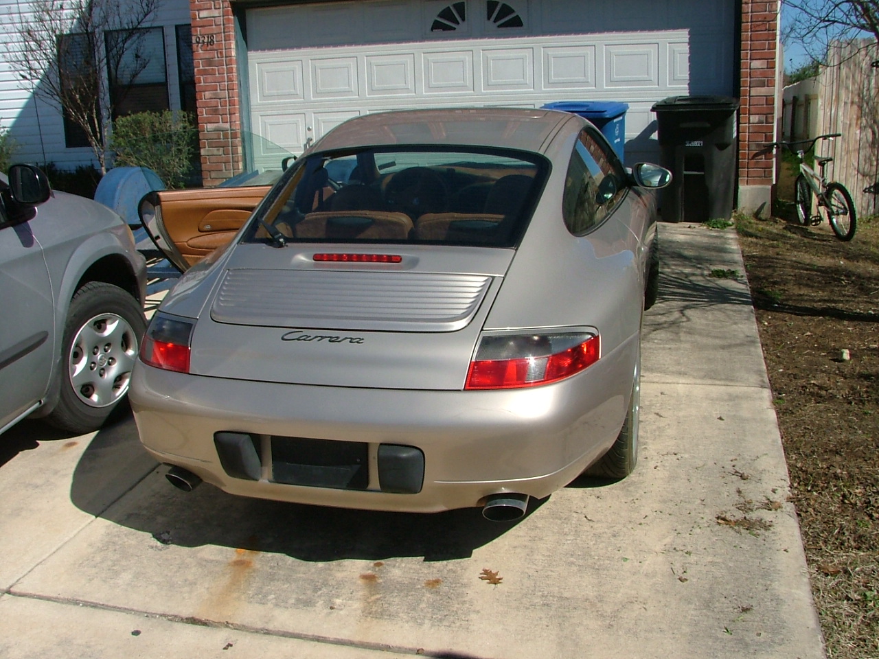

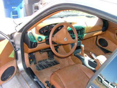

I have inspected the car and found that there is a water line inside the car at about mid-speaker level. (about 6inches deep in the pax compartment) I took some pictures and have posted them at http://community.webshots.com/album/576834171nqlgop
I connected the battery and saw the instrument panel light up and function normally. The car will not crank at all. The radio will not work and the red anti-theft light is blinking. This is probably the result of a loss of power from the disconnected battery. You will need to get the codes from the dealer to get it working again.
Looking in the front trunk, I could not find any sign of water in the front trunk at all.

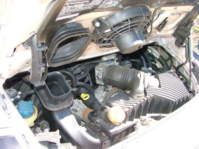

Engine compartment...The aluminum components are showing some light corrosion that is typical of a gulf coast car again little or no indication of water damage. The engine inlets are clean with no silt or leaves. I did not remove the air cleaner.
The engine is free and will turn over normally when the car is pushed a few feet in gear.
