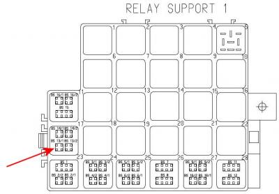

Why not connect it to the switched supply for the PCM? That's the orange wire going to pin 3 of the blue connector.
Alternatively, you could splice in to the bottom connection of fuse E1, or to bridge plug 13/1 on the relay panel.
Edited by Richard Hamilton
I finished my little project today with adding an extension fuse box. I tapped into the seat heating fuse to do that which is switched. The extension box I placed behind the factory fuse box and secured it with duct tape and ran the wire behind the carpet to the center console. Attached a few pictures to highlight.
