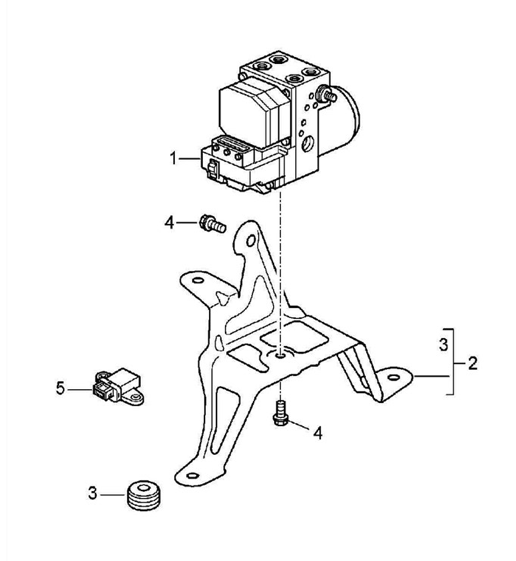

Many thanks jpflip.........
No mention of PSM with the unit referenced at AA?
So are we to assume then that the ABS control module is part of the Hydraulic brake unit & also functions as the PSM module? Was under the impression that the 'control module' could be removed with out compromising normal braking operation. (no ABS obviously)
Lastly where is this item located on this vehicle?
Cheers,
J

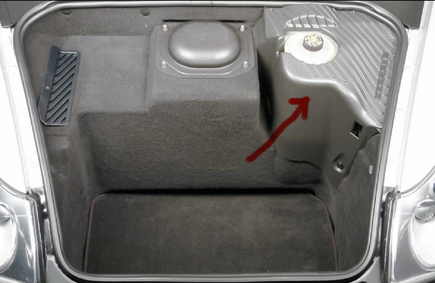

Located under this panel.... Try to get all the wiring inspected properly before you replace something so expensive.... Good luck.
