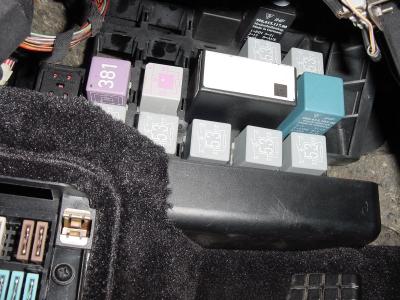

I'm only familiar with the location of the convertible top relay on the 986. If it's in the same location on the 987, then you will find it in the relay tray in the driver's side kick panel (to the left of your calf when your left foot is on the clutch pedal).
As RFM says, the 987 is no longer a double relay, but here is a photo of the 986 double relay in the relay tray:
You can just see the top of the "dead pedal" at the bottom right corner, and the top of the fuse tray at the bottom left corner. The convertible top relay (again, this if for the 986) is the one with the black square on the white background.
