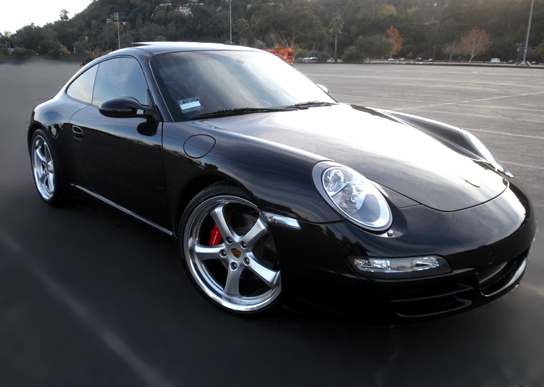

I was wondering if there was a replacement bulb for the "driving" lights (below headlight in picture) to a "whiter" bulb that would match the color of the Xenon headlights.??
I feel that the standard bulb is too "warm" in color temperature. It's just an aesthetic thing but I think it would look cleaner if the two light were approx the same color temperature.

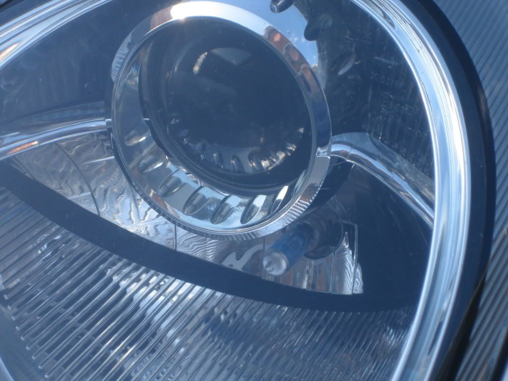

Are we talking about the hi beam driving light or the sidelight DRL units here? I have a blue tinted hi beam bulb in my 987 with xenon headlamps which matches the xenon gas discharge colour very well. The DRL or sidelight bulbs I used are LED items with built in resistors so they dont throw bulb errors. The blue tint on the hi beam is similar coating to that found on the OEM supplied phillips vision sidelight w5 bulbs. You get no loss or gain in vision using these bulbs just a different light colour.

Bulb in headlmap unit . You can make out the blue tint
