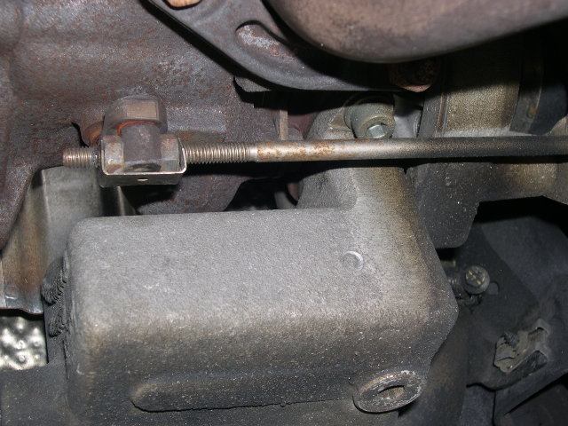

Is there a modified program in the ECU ("flash"); what do you normally see under boost on the gauge? take a look under the car to see the actuator rods for the waste gates are still in place. They are mechanical and pneumatic actuated via a tube to a piston. If the gate isn't moving the ECU will see excess boost then start dumping boost/retarding timing (the engine will protect itself).

Did somebody try to adjust the turbo waste gates? If you put too much boost the ecu will try to protect itself.

Thanks for all the replies. I can confirm that there is no check engine light and that I don't think there is a problem with the wastegates because I recently had a restricted 0.4 to 0.5 bar boost after messing around with the electrical connector on the MAF sensor and the car was effectively running on the wastegate spring default pressure. This has obviously been resolved but I have too much rather than too little boost. My first thoughts were that the spark plugs and / or coil packs might be faulty but the fact that it is boosting to 1.4 made me think that an overboost situation might be the cause. I'm not sure whether or not the ECU has been flashed. Is there any easy way to check it out? I have a Galleto 1260 that can interrogate the ECU to see what ECU file is installed if somebody knows what I need to look for.
I was under the impression that the ECU can electronically allow the boost pressure to be higher than the wastegate sprng pressure by bleeding off some of the pressure from the wastegate actuator hoses. As the Diverter Valves look like they are purely mechanical it would stand to reason that there must be another device in the system that taps off some of the pressure.
