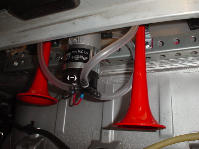

Last year the front of my Boxster was backed up into by a truck and could not get away because there was a car behind me. The body shop fixed all the damage but I asked them to hold off on putting the new bumper cover on. I took the car home for a day and found the loudest set of air horns I could find at the local parts places. Put them in then took the car back to the shop for the bumper cover. Would have like to try the Groit's horns, but that was not an option due to time.
The air horns are in additional to the oem electric horns. So now I have 2 sets of horns. To power the compressor I piggy backed a wire to the wire for the electric horns. I was going to used a switch, so I could switch between horns, but then I though I would never have the time to play with a switch in an emergency.
