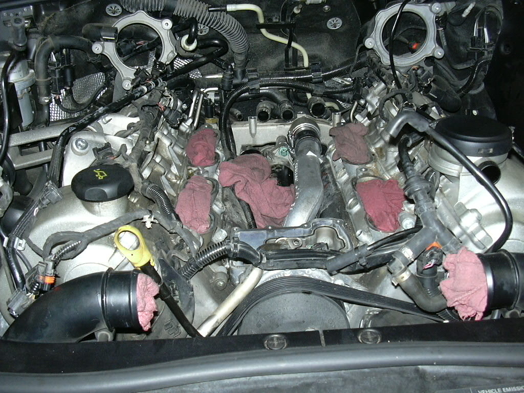

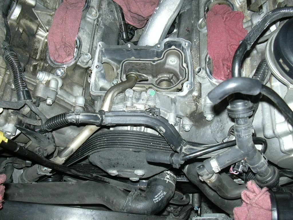

here is the general location of the tubes. Hope this helps!
