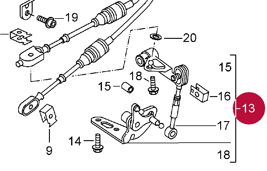

I attached a picture of what the linkage on an 02 Boxster looks like for your reference.

That is great! I hope that is it, as it will be a quick repair and you will not have to wait for Christmas for a new tranny to arrive from Germany!
DC
I did the RMS / IMS last week and with the tranny out gave it a thorough cleaning. While rolling it over I must have bent the L shaped bracket (#18 in the diagram). A gentle tug with a tire iron put it back into its place and all is good now.
