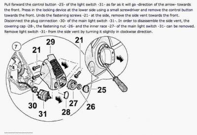

I would like to replace the 2 side air vent wih new carbon fiber parts but, after Having removed the 2 torx screw i can't make slide out the original part.
Looks like there's another screw inside, on the right of the light switch.
Inputs ?
Thank you
Inputs ?
Thank you

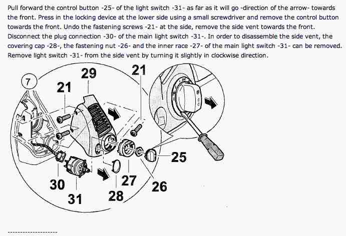

Yes, for the drivers side, you have to remove the switch first....see here:
