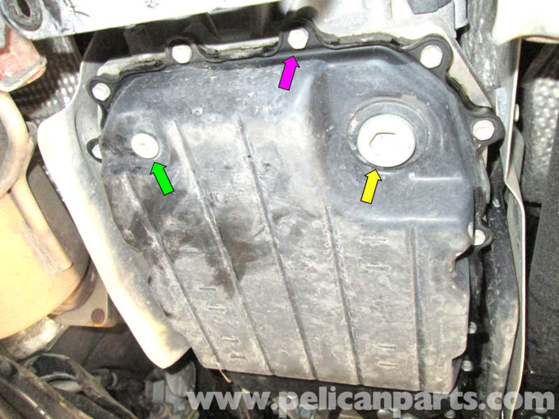

I got the feeling that there is maybe a little bit of oil missing in my transmission.
could i check it by myself?  adding oil until its puring out from the fill plug ?
as i remember the car has to run during the filling process? isnt this ending up in a mess because the oil is fluctuating in the oil pan?
thank you for your input.
It’s not hard - and you might as well top it up while you are at it too. Get a liter of Mobil D3309 transmission fluid and a pump for the bottle with a long hose. You can put it on jack stands, but I just put it in special terrain mode and turn off regulation (important!). Make sure it is level. Crack the filler plug (17 mm allen hex wrench) before you start, as it might take some force. Don’t remove it. Put a tray underneath for spills. Then start the engine and monitor transmission temperature with whatever is your cable of choice. When it gets to around 36 degrees, take the plug out and stick the hose in. When it gets to 40 degrees, pump in the fluid until it overflows, close it up and you are good to go.
If the fluid in there on the plug is a golden or amber color, it might be the original fluid. The Mobil is red, and I am not sure if mixing them is OK, but after reading countless threads I think it is. But everyone has a different opinion of these kinds of things. If it is red then the fluid has probably been changed before.
You said you think it’s low - a good sign that it is low is when you start driving when it is cold and soon after starting the engine, it goes into 1st with PSM on (as you know it should start in 2nd). When it is really low, it won’t want to shift from 2nd to 3rd. This will happen independent of any valve body issues.

@Zakowsky Mike thank you very much for  your detailed post.
Actually the car had a trans oil flush some years ago. So i would say the oil is in there now for 30k km.
What you describe sounds pretty easy. I will try it. Just have to find the right equipment.
The filling has do be done whilst the engine is running?
It's not too hard. Yes, the engine has to be running; that is why I prefer to just raise the suspension and turn it off, and put jack stands in loosely just in case. I don't like being under a running vehicle which is on 4 jack stands for some reason! Trust it less than I do the air suspension system.
Some people say you should have a person inside that puts the transmission in drive and reverse for a few seconds while you are filling, but I have never noticed a difference in how much it takes by doing this. And with a leaking torque converter seal I have done this a few times. But after reading about what Lewis is going through, now I don't want to get it fixed!

Don't forget that the fluid needs to be at a temperature of 40C in order to get the fill level correct.
The fill port is kind of like a periscope tube that goes up into the pan. If while running and warm the oil doesn't pour or drip constantly when you pull the plug start filling immediately. What you want to do is fill it, let it drip as it warms and the oil expands with heat, then plug the filler when it reaches plug it when it reaches 40'C. Once the oil temp passes about 35'C it starts heating fairly quick, especially with the summer temps you're probably getting in Frankfurt. An Aisin specialty company in California said it tolerates being a little over filled but not underfilled. If you cap it at a higher temp it will be underfilled.

So tools bought, oil bought.
Try to open the fill plug. No way. I need a lift to do it. From terrain level no chance.
Second reason I should not have drive the car. It stay there for 2 hours after. Trans oil temp still 69 degrees. To much for this process.
