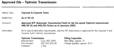

I think Porsche uses Mobil 1 ATF 3309 in all Cayenne's auto tranny based on my research.
However you have to idle the engine and make sure the tranny temp is 40C to get the correct fluid level

On many forums, I find that Toyota T-IV ATF is actually Mobil 3309. T-IV meets JWS3309 and it is for Aisin AW transmission.

I just got my CS2004 fluids changed @ 64K miles (Transmission + ATF Filter, Transfer case, Front and Rear differential). I bought the car recently and was not feeling good until I do these changes considering the life of the transmission is very much depending on its fluid! so i did that at 64K rather recommended 120k miles.
Anyway, they could fill up the transmission with only 6 liter of fluid where as the manual says change will be 8 liter. I am now afraid if there is not enough fluid in the transmission that could cause foaming inside !! I know that there will always be some oil remaining in Torque Converter and Cooling Pipes that never flush but could that be 3 liter of fluid so that they added only 6 litter? (I think the total capacity is 9 liter)?
Has anyone done this to inform how many liter they filled in?
Thanks in advance.
I recently did my ATF fluid and filter and had a similar experience. I could only get 6-7 quarts in. I then read the instructions more carefully and saw that the procedure to refill should be done with the transmission in neutral and the engine running.
To sum it up fill until it over flows with the engine off(you've already done this), then install the fill plug and shift through D, reverse and 2 repeadedly. Then shift into neutral open the fill plug and top it off from there. All the while the transmission temp needs to be >40 degrees C. I had durametric to read the temp, if you don't, >40C was achieved after about 10 minutes with the engine running and the transmission in D (remaining stopped in the garage the whole time).
It seems as if being in neutral was the key to success to get the last few quarts/liter into the tranmission.

Yes I was able to get ~9 quarts in when I followed the above procedure correctly. It ended up taking around 9.5, but that was after I spilled about 1 qt on the floor. It was a messy job.
