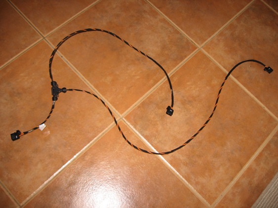

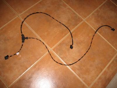

In my 03 996C4S, the CD changer was a dealer installed option, using Porsche stuff. The CD changer is in the front trunk, as is the amplifier. If I remember correctly, there was a cable that ran from the amp and a cable that ran from the CD changer and they both merged to make a Y shaped cable which then connected to a single cable running to the head unit. The connection to the cable that ran to the head unit was under the carpet somewhere around the brake fluid reservoir. I replaced the Y shaped cable. It was easy. I might even still have the bad cable with the part number. I'll take a look this afternoon.
Faulty memory - the cable does not have the part number on it. I've attached some images, though, that might help you locate the cables.
First image is of the Y cable I replaced. This solved the problem for me, although I suppose if this didn't work, I would have next suspected the CD changer and sent it for a bench test.
Second picture is of the front trunk of an 04 986S which has been stripped of all the carpet etc. (it is a race car) You can see circled the end of the fiber optic cable where it used to connect to the amplifier, and the arrow shows where that cable connects and goes into a protective plastic conduit before heading off into the cockpit. It is at this place where the CD changer and the amplifier came together in my 996.
Third picture is of the front trunk of my 996. The circle is the general area where I found the connection for the Y cable, and the arrow just happens to be showing where the amplifier cable is showing a little bit.
Hope the problem ends up being a cable for you too - while not cheap, it is less expensive than the head unit or the CD changer.
