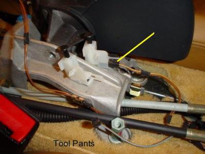

On the driver's side of the center console, right behind the seatbelt receptacle there's a small panel.
Pop it out (held in place by pressure clips).
With the handbrake pulled up (engaged) look at the base and you'll see two wires (IIRC white and brown) with a white connector at the end plugged into the handbrake's microswitch.
Pull out the connector and clean the microswitch's connections and spray contact cleaner onto it while manually operating the switch.
Reconnect and replace panel.

It's an inexpensive part so why not just replace it? It can be changed out without removing the console in a few minutes time.
The parking brake switch acting up is a common problem with the older cars. Porsche came out with a new switch in 2000. Remove the center console and replace it with the new version.
