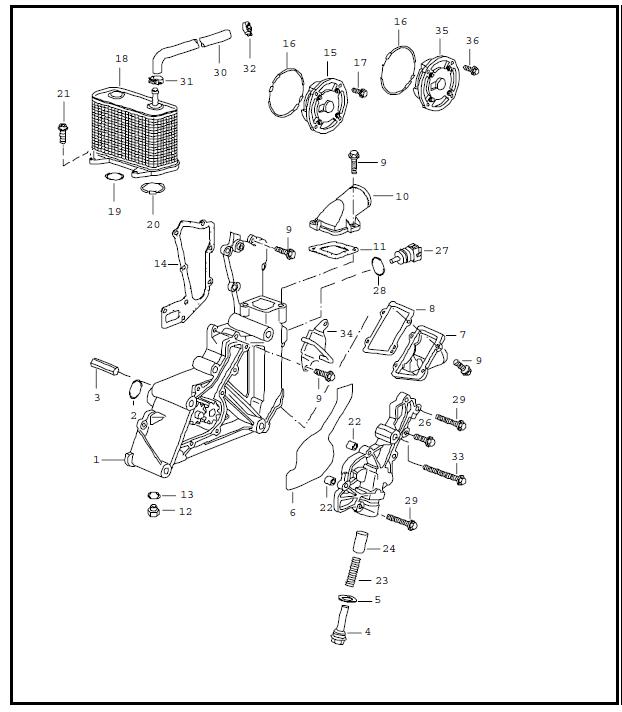

Ok, thanks, can anyone point me in the direction of where I might find this on my 997.1? Is it easily accessible, or do I need to be a contortionist with telescopic arms to find it in the tiny space around the engine?
Ok, thanks for the diagram, excuse my ignorance, but where is this part in the car, guess it is in the back, but is it something I can find easily or is it only really accessible if I remove most of the 3.8 block? Is it near the coolant tank on the left rear, or more likely on the engine somewhere?
Here is another picture. The story says it is on the
right cylinder bank. My guess is it is the passenger side.
The black object looks like the sensor. Part number one
from the previous picture is the oil pump.
Paul
Thanks again, I went out to look in the boot (with a torch because it's dark here in France) and as I was looking the police turned up and asked me what I was doing!! Anyway, I couldn't see that part, is it visible from the boot or not? If you can tell me where to look then maybe I can find it! Thanks!
My guess is the rear passenger side. I would wait until
the morning. Open the engine lid to get some light in.
You might be able to look up around the engine exhaust pipes.
Paul
