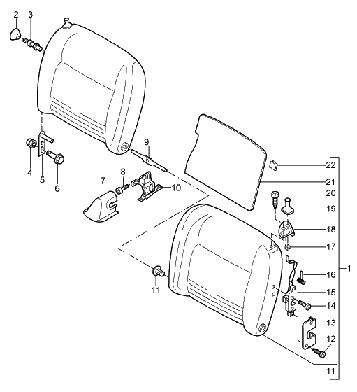

I am piecing back together a 2000 996 Carrera 4 and need help with the rear seat backs. The hinge pin located on the center tunnel of car seems to be too short to mount both sides. Is there a piece that I'm missing (an adaptor or extension or something). Then the outer hinge, I could use a picture to show how that mounting bracket is put in. And then it looks like i'm missing both pins that hold and lock the seats in an upright position. Any idea where I could get those? or a part number?

Your rear seat parts should look like this.
Thanks Loren! That answers that question. I am missing a couple of parts.

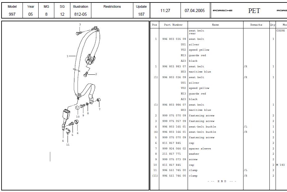

Here is a picture of the rear seat belt.
Paul
Thanks Paulspeed. Unfortunately, that does not reveal the inner "guts" of the mechanism that retracts the belt. Any other thoughts?

Does anyone have part numbers posted in first schematic on this post? I am also reinstalling seats and I am missing a few parts.
Jimmy
Jimmy
Yes, give model and year of your car and which item numbers you need.
