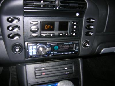

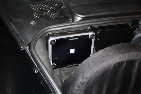

Santa Claus was very good to me this year. I got a new alpine head unit, amp and focal speakers to go in my 03 996. I went with 5"1/4 speakers for the doors, tweeters are installed in the dash, and I mounted a set of three-way 6x9's in the quarter panels. I hid the crossovers behind the amp to make it look as clean as possible. The sound difference is AMAZING!! I highly recommend the focal speakers if you're looking to upgrade.

Access 130 A1 for the front. The mids will bolt right into the factory location in the door. I mounted the tweeters to the dash frame under the factory grilles and used the existing wiring harness. The rears are RIP 690 C. I used a dremel with a 1/4" router bit to slowly trim away enough material for the speaker to fit.

Did you retain the original Haes amplifier?
Bob
You can't use the existing amplifier with the aftermarket head unit since it's controlled by a fiber optic cable. I have seen photos of crossovers mounted in that location, but lots of wiring is exposed and it looks a bit too busy for my taste. I left it in place to help conceal the wiring, but it's not connected. Hope that helps.
Very helpful. I have an 02 996 C2, which does not have the MOST nomenclature, but my 6 x 40W Haes amp looks like the one you left in place to hide the busy stuff.
What are the model #'s of your Alpine head unit and amp. The Alpine PDX5 amp looks tasty, but since none of the sellers on the web want to show the details of where the wires go, and where you need access for control settings, I can't tell if it will fit in that deeper area next to the Haes.

I went for the OEM look and managed to track down a Becker Traffic Pro:
Next will be upgrading the speakers with Focal 6.5", 4" and tweets and a decent 4 channel Soundstream or Genesis amp. Will also be replacing the CD Changer with Solisto Ipod /USB stick player very shortly.

Bob,
The PDX 5 is larger, I don't think it will fit in that same spot. You could put it lower in the compartment, or maybe under the passenger seat.
