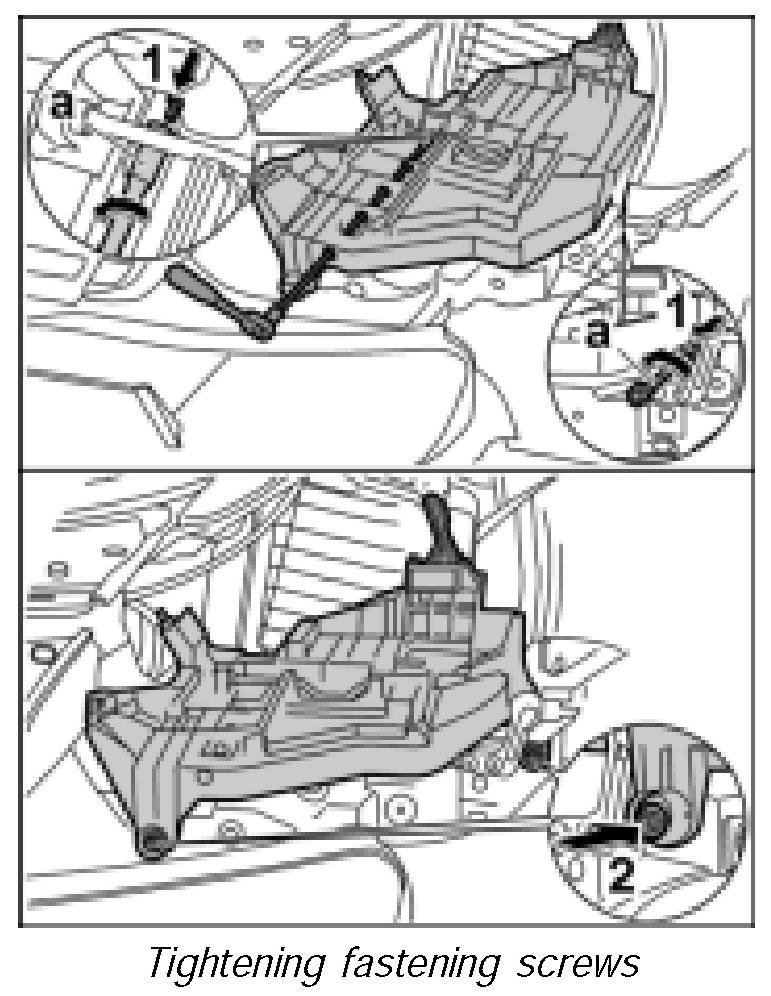

2006 Cayenne Turbo S.  Left front turn signal wasn't working.  Used a RennTech tutorial to remove the assembly, found the bulb was fine, reseated it and signal now works.  However, in the process I appear to have stripped the gear on the mounting plate and can not lock it back in.  Found it available online a few places and will order.  Question: How would you keep the assembly in place to drive the car while waiting for the part? :)
This is for my '05 V6, you got to take off the front bumper cover and wheel lining for the side you're working on.
Hope this helps
