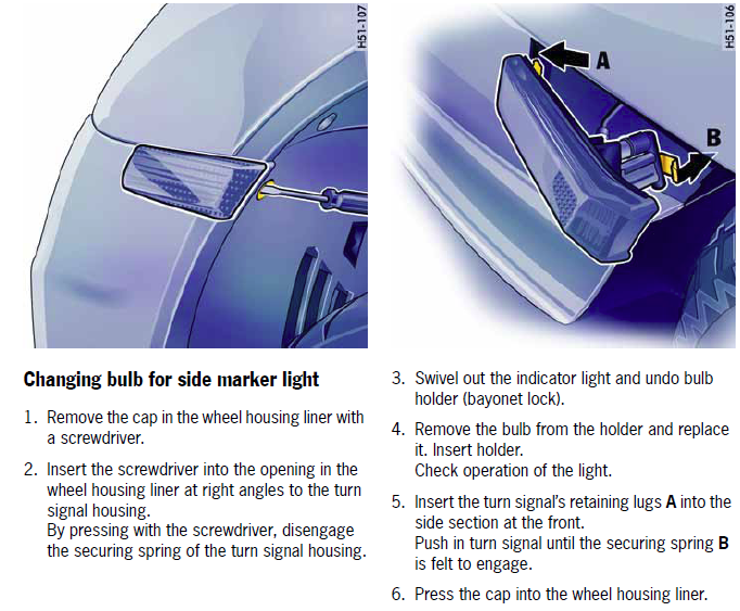

Hey there folks. Ive searched and searched. Have a blown buld in my right side marker light. How is the lens removed? Ive looked at every which way and cant seem to see it. Thanks in advance..
