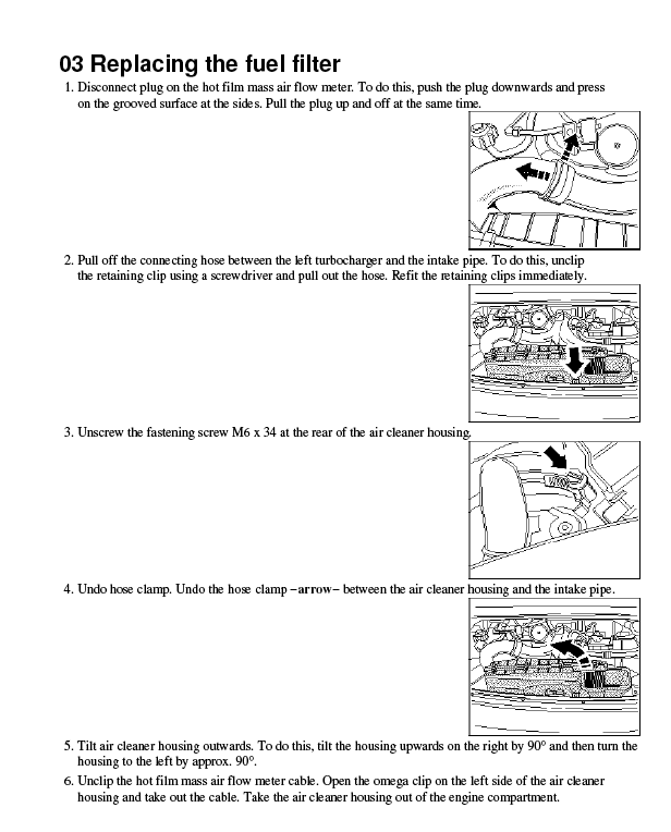

Can some one share a DIY on how to replace a fuel filter on 996tt , i highly appreciate it.
MY please...if it is 02+, the fuel filter is part of the fuel pump and is not normally changed.
There is a fuel filter on the left side over the engine. Part# 996 110 253 52 about $40.00. Located just beside the coolant reservoir. There is a way to lower the engine about 2 to 4 inches to give you more space. ......
post-29683-1262128714_thumb.png post-29683-1262128728_thumb.png post-29683-1262128738_thumb.png post-29683-1262128748_thumb.png post-29683-1262128964_thumb.png
Right there Wross...

Thanks to everyone that responded to my querie. I learned already how to do it. but last time when i tried to lossen the 18mm bolt ,i was unsuccessful.any clue?
Maybe I should use impact torque wrench?
The only thing I can tell you, I had to used 1/2 inch drive ratchet with a 3 feet pipe over the ratchet handle and it work! The torque of these two nuts should be 85 foot pound.....
