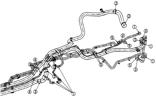

When should the coolant hoses be changed? I watched Motor Week last night and they were saying 4 years or 60K. I think I read that our coolant is good for 100K.
How many hoses are their and what are there locations?
Stan
2001 6spd 996
30K
Porsche suggests inspection of hoses at 30,000, 60,000, 90,000, 120,000 miles but does not recommend replacement unless leaking or damaged.
Here are the hose clamp locations (both pics for C2) (a C4 is slightly different):
