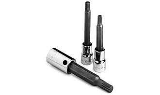

You will need a small set of torx bits, torx female sockets, and a few triple square bits......When I say a small set several companies sell a set of six popular sizes. In my case find I get away with three or four sizes in most instances. For the triple square, these are a 12 point bit used on an internal wrenching screw or bolt. So far I have seen them on seat bolts, engine torque links etc. I have used two, a 10mm and a 12mm. I have attached some examples from SK Tools...Hope this is of some help...
Bob
post-40826-1261360787.jpg post-40826-1261360800.jpg post-40826-1261360811.jpg
