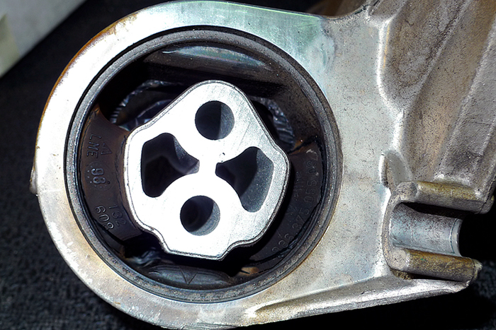

You could check it without removing it but I don't think very thoroughly as you can see by the photo I've posted showing Pedro's Techno Mount installed on my '99. I've also included a pick of the OEM mount that had 77K mi. on it and as you can see it is cracked all the way through and worn out. My Box has a Tiptronic trans and to be honest with you I did not notice any difference in how the car drove after I installed the new mount except I opted for the Pedro's Enthusiast Mount which is beefier, larger designed for the occasional tracker and AXer. The mount transmits a significant amount of vibration into the cab which I knew about and accepted as a compromise to equip the car for the stresses put on it for track use.

I've found it practically impossible to thoroughly check the front engine mount without removing it.
Even using an endoscope-type camera is not good enough.
The main reason is that there are two rubber stoppers on either side of the central core which prevent seeing the core.
Also, because the rubber is black, it's difficult to see a crack unless it's well lit.
My rule of thumb is: Over 45,000 miles, I guarantee it's gone (OEM mount).
But it's really not that difficult or time-consuming to check.
Maybe 30 minutes to remove the panel, support the engine with a jack, remove the yolk, loosen the mount bolts and lowering engine.
