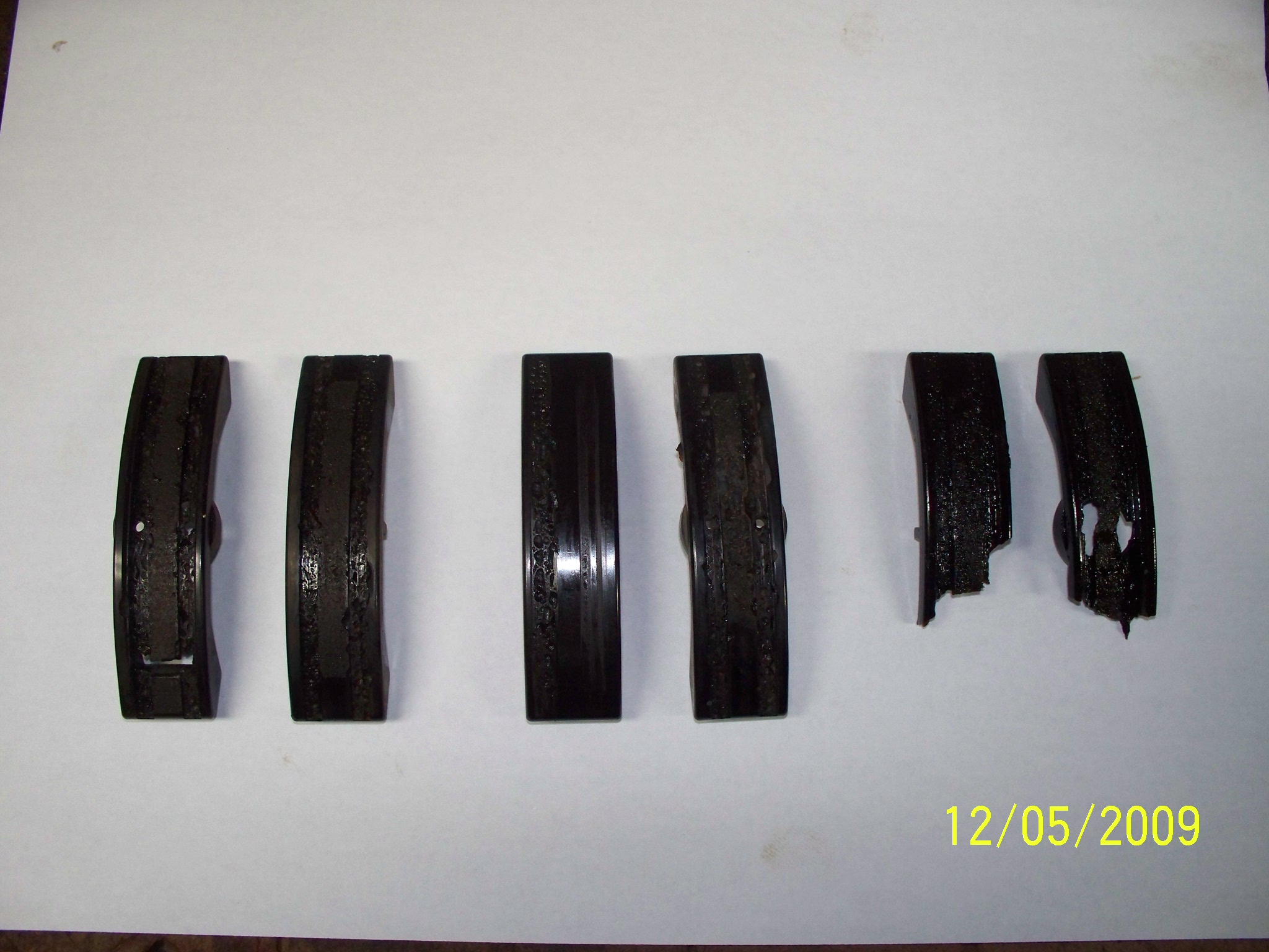

Here is a picture of the camshaft shoes that I removed from my 1997 Boxster.
The pair on the left were on Bank 1-3 and the air on the right were on Bank 4-6.
The car has about 100,000 miles. I changed the complete Varia cam unit with a used one from Oklahoma foreign last spring.
The car was throwing codes and timing on bank 1-3 had jumped. As you can see the 4-6 bank was no better...I has planned on changing them this winter, and am glad I removed engine to do so.
It is considerably easier to do a good job with engine out of car...
Wow, and I thought the ones on my 996 at 50,000 were bad. But why three sets? There are only two in an engine. New sets are only about $15 from Sunset. You should look at your oil change intervals and the type of oil you are using. This can lead to excessive wear if you don't change your oil often enough and use the wrong oil.
Oil changes at 5000km since I have owned the car...damage was from the Previous owner...three sets because I changed the Varia cam unit and it came with shoes.
I knew I would be tearing into the engine in the winter as car is off road until April...

A fairly common problem on the 986/996. My brothers 99 had guides nearly as bad at 68k miles. A combination of lame materials and long oil change intervals recommended by the factory.
