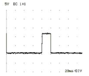

Check signal from airbag control module.
1. Connect special tool 9637.
2. Connect engine tester (oscilloscope) to pin IV/16 and ground. Use special input.
3. Ignition on.
The signal shown opposite should be displayed
3. Ignition on.
