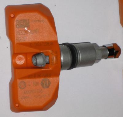

Phillip,
The TPMS must be installed prior to mount and balance. However, they may not fit your new rims, it all depends on the wheel profile. The wheel manufacturer or installer should know if they will work. So, in answer to your question, you will have to re-mount and balance the wheels and tires if they do fit. Attached is a picture of a sensor.

Phillip,
