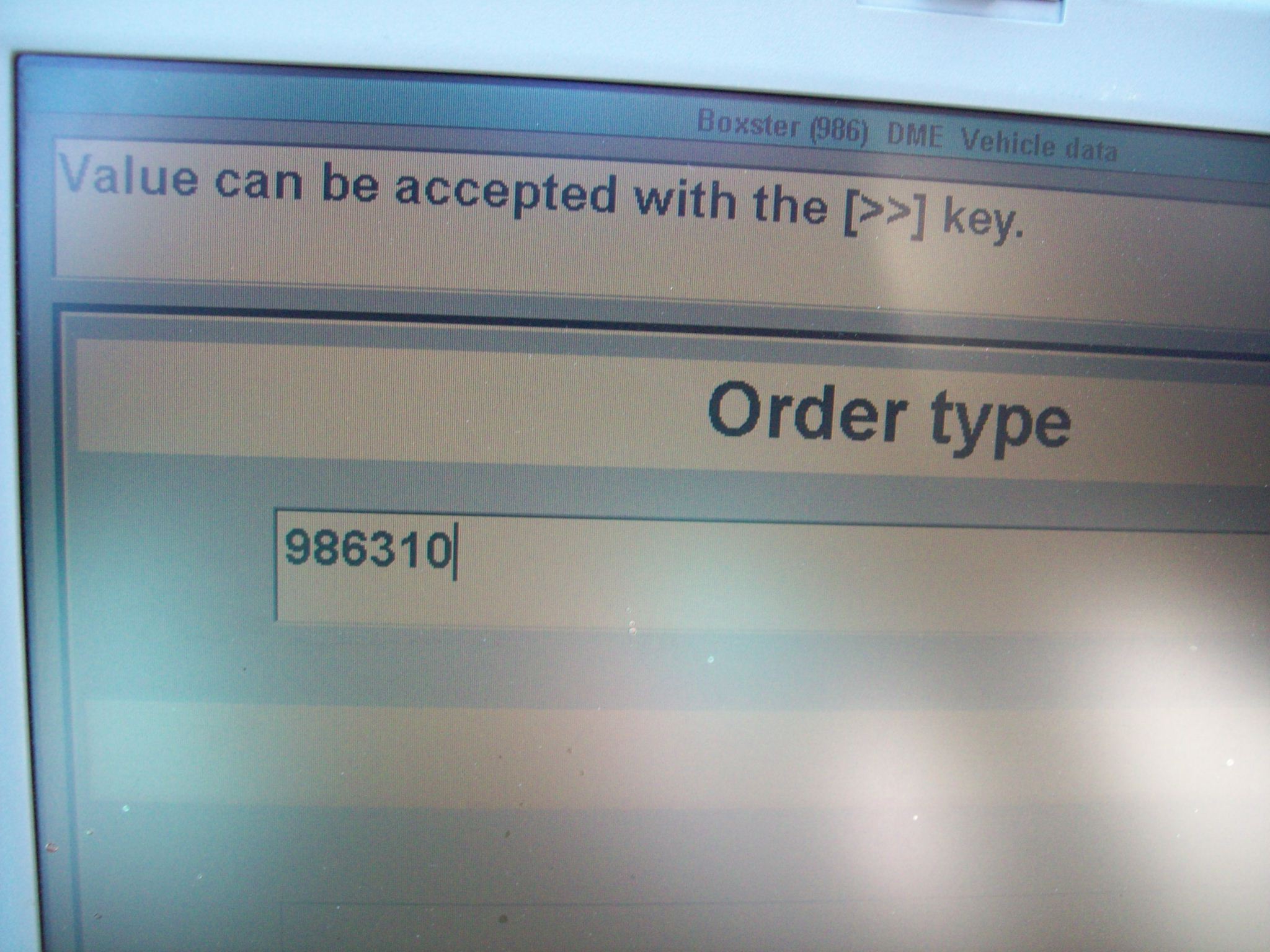

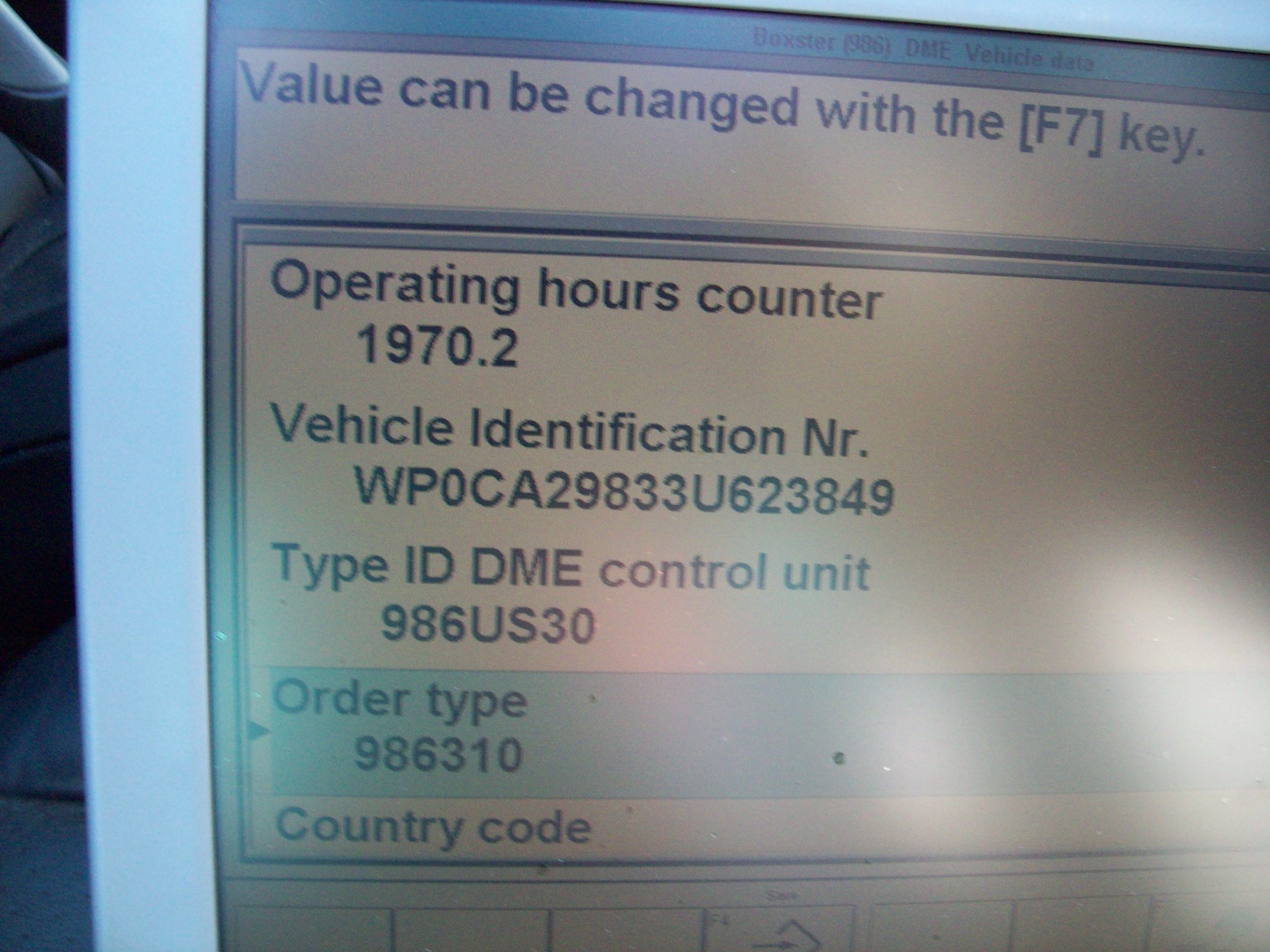

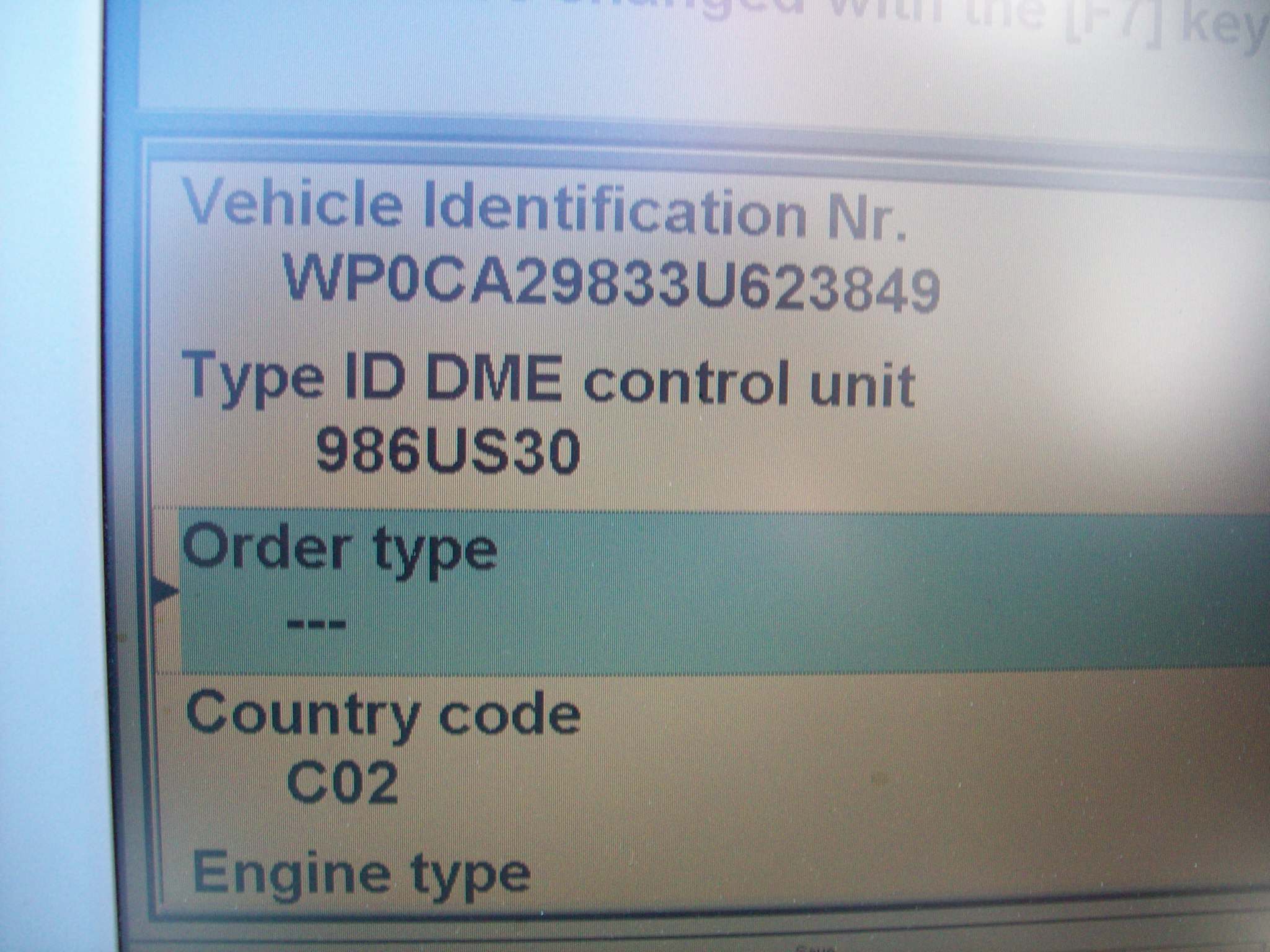

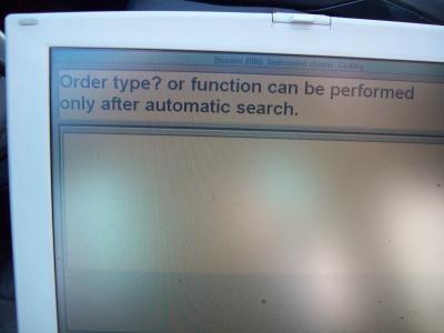

But the OBC still has to be turned on. As Loren said the tech needs to enter the order type/model number in the DME, which for a S is 986320. Then he has to start the automatic search all over ago. Then go to the instrument cluster. Then go to coding. Change the coding from without OBC to with OBC. You cannot turn on the OBC unless these steps are followed for 2003-2004.
I do not know why the techs cannot figure this out, because there is a prompt "Order type ?" when you try to change the instrument cluster coding, because the order type is missing from the DME. Instead the DME has three --- for the order type. You enter the order type in the DME, then instead of seeing the three dashes you see the order type that was just entered. Once that has been entered you cannot go straignt to the instrument cluster coding. You have to start the automatic sear all over again, then go to the instrument cluster, then to coding.
Watch your instrument cluster while this is being done. Once the coding is changed to with OBC the instrument cluster lights will turn off, then go back on. There will be a gong sound. Your trip odometer will reset to 0 miles. Then you know the instrument cluster coding has been changed.
