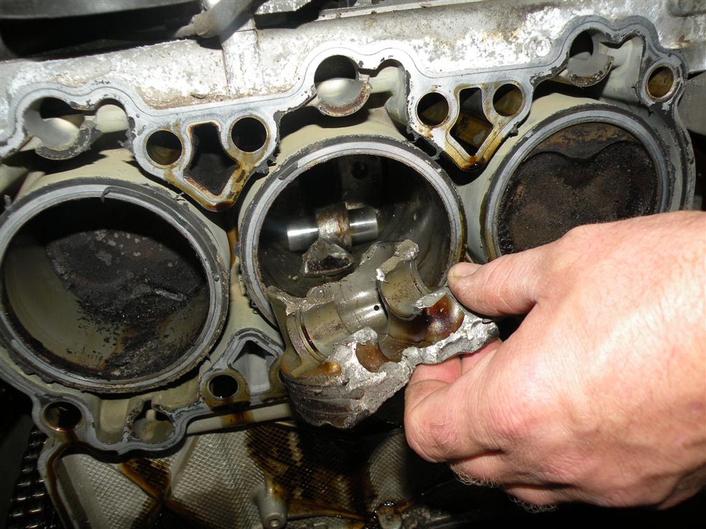

Sounds like a classic MOF#14 to me.. Piston failure.
Been there, done that have the pieces on the trophy shelf to prove it..
There are lots of things that have this same set of symptoms, like a slipped sleeve, D chunk failure, etc, etc,etc..
You have to find out if the motor turns at all.
Now that the serpentine is off you have to get a big socket wrench as txholi4life said and try turn the crank. it's not easy but if you can torque it around a bit (1/2 turn or so), this is a good sign.
