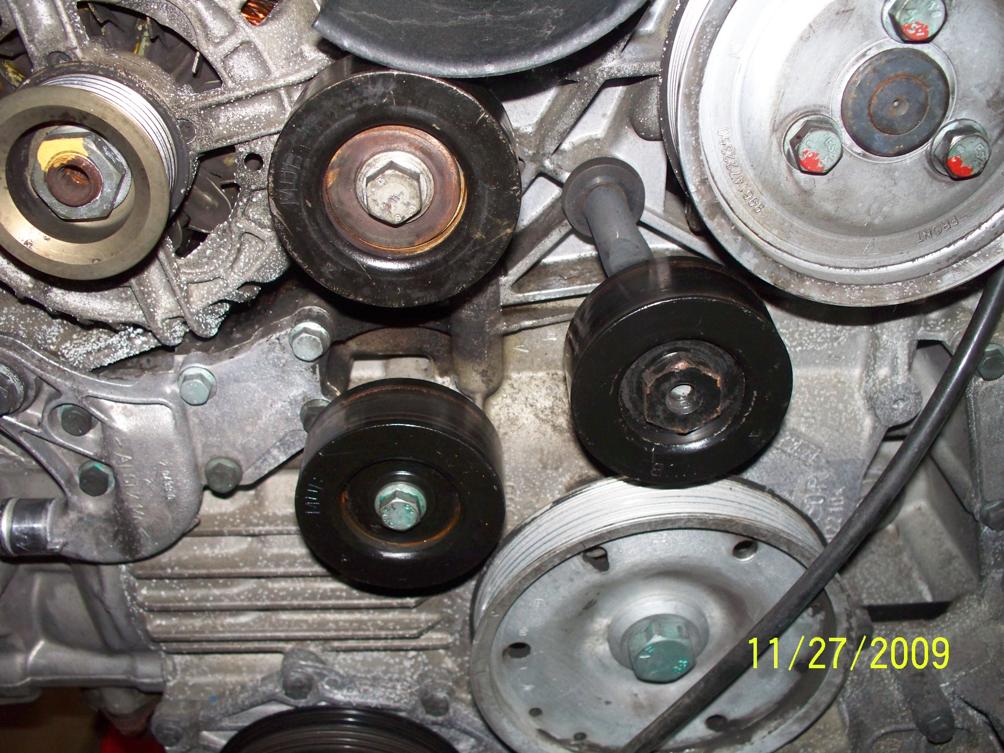

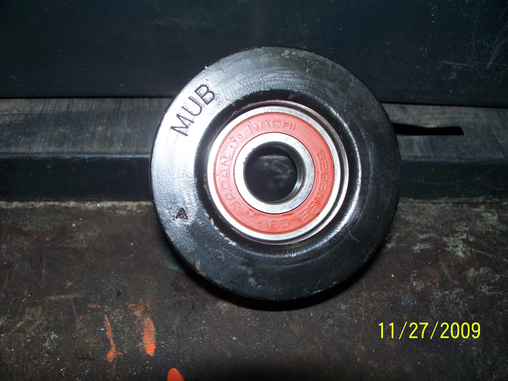

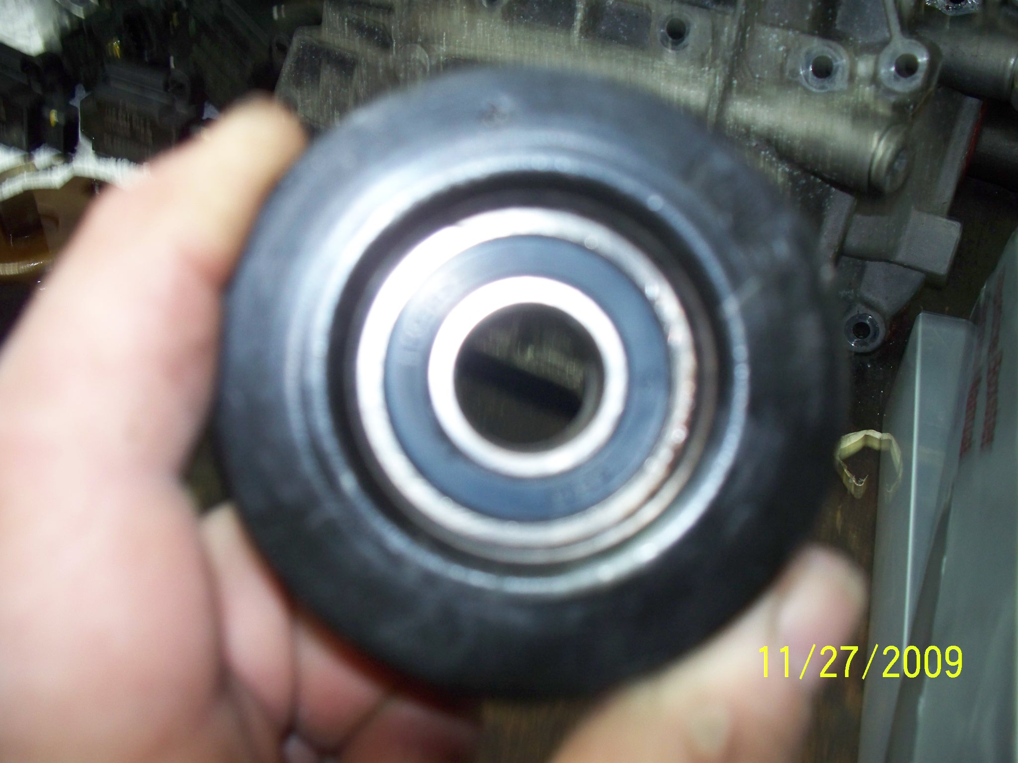

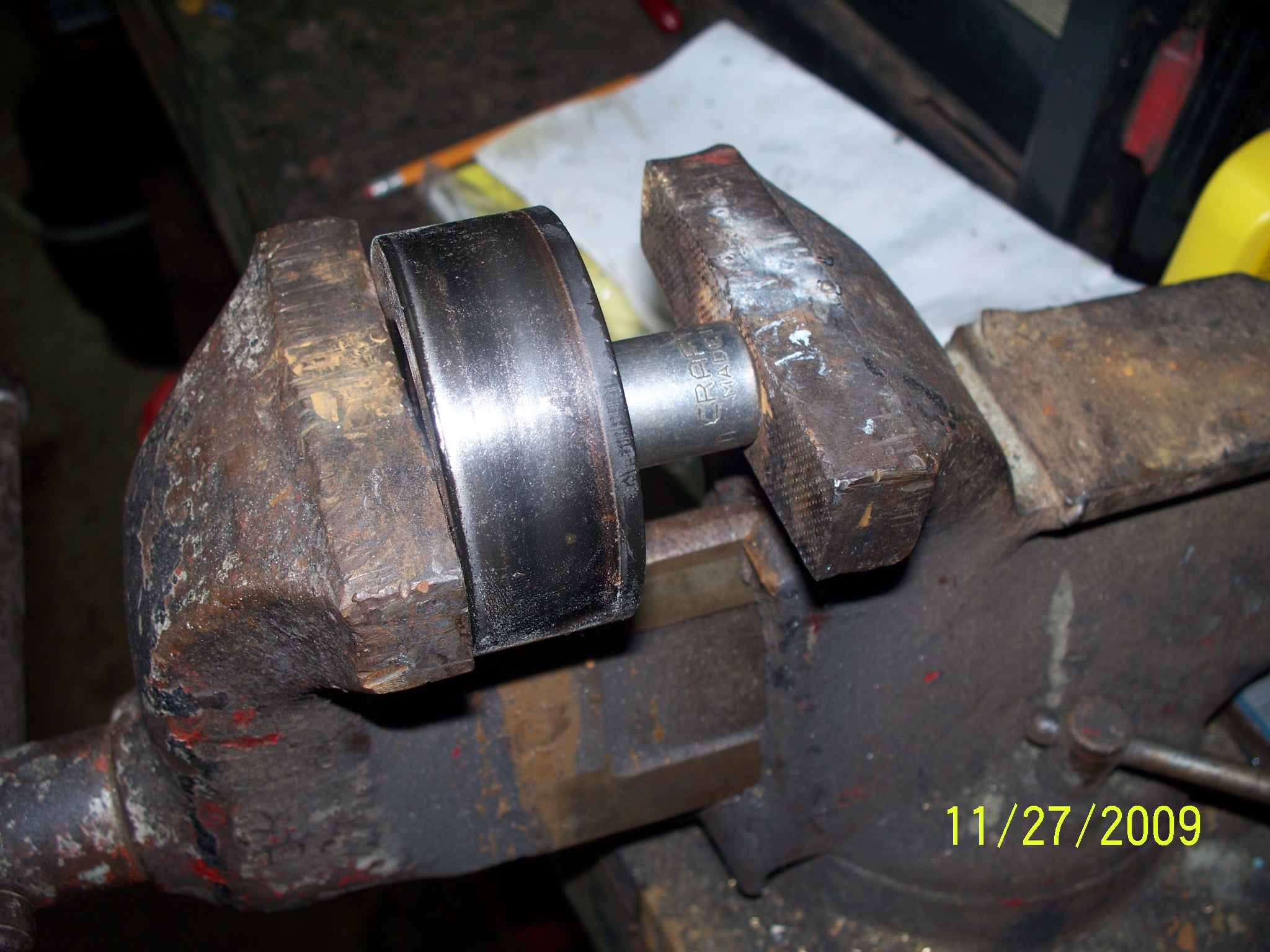

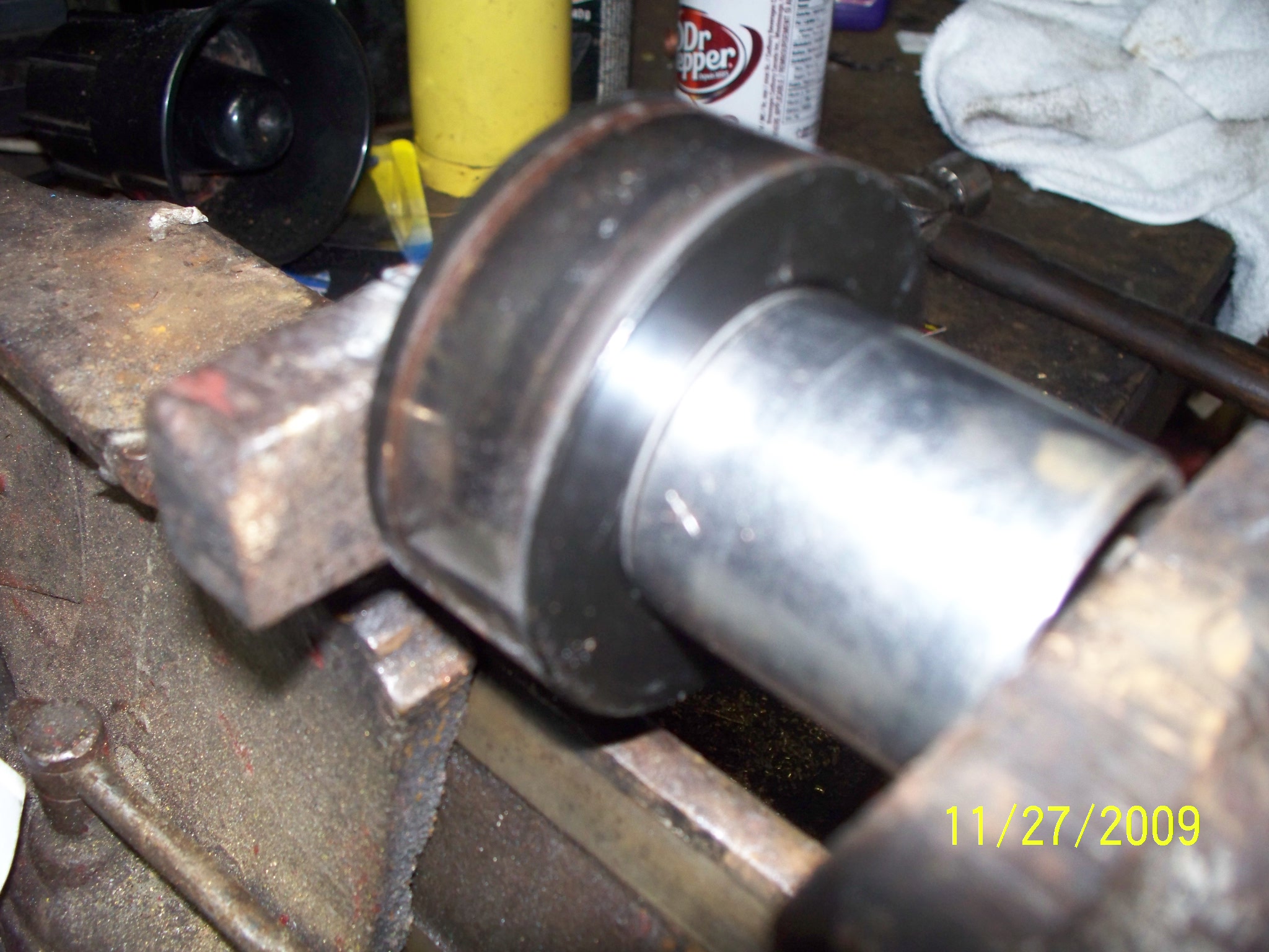

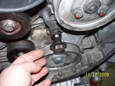

When I first bought my 1997 Boxster, I trailered it home and took it for a ride to my kids school. One of the serpentine belt pulleys locked up and it threw the belt off.
I loaded it back on the trailer and brought it home. I took off the pulley and replaced the bearing as I am cheap. Now that my engine is out of the car I replaced the other 2 and snapped some pictures. The bearings cost me about $8.00 each (I buy quite a few bearings each month for my company) It is really easy to do if you have a vice to use as a press. The bearing I used was a 6203 NSE Nachi.

All the bearings are the same size in all the serp pulleys.
The tensioner pulley has a 15mm bolt in the back and a 15/16" (?mm) on the front side.
These pulleys are also all the same, regardless of function. Good luck.
