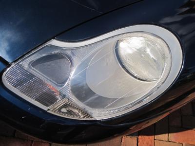

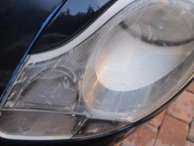

In an attempt to remove the oxidation off my headlight covers, i bought a 3M sandpaper/polish kit from autozone that came highly recommended by the manager. the sandpaper padding attaches to a drill.
I feel like such an idiot..... Despite following all the instructions, the sandpaper has created white marks that seem permanent. they're not really scratches as much as they are just opaque marks that seem embedded into the plastic. Have i ruined the headlight?
I re-did the entire process hoping a second round would remove the scratches.
What are my options here? i am literally sick to my stomach at the thought that i damaged my baby. it looks much worse in person - the pictures don't capture the extent of the marks.

Doesn't look good! Looks like you have gouged the plastic with the high speed drill. I would probably try some fine grain wet sandpaper and buff by hand. Then use a plastic polish to finish it off. Odds are that it will never be the same, because if you get the gouges out, it will still have a warped look to it. New headlights might be in order!

Depending on how deep the marks are and if they've been created by the heat of the drill:
You can do no harm by using some wet and dry 1500 fine or 2500 which is very fine. Something like SCRATCH-X (or T-CUT or PLASPOL) will help at the same time. Use the wet and dry with warm water to dip it in with a little Fairy Liquid in the water. Just try it on a small area a few inches square to let you see the results and to give you an idea of how long you need to rub in circular motions and how it is working. You will probably need to go at it for a while because those wet and dry grades are fine.
Take the headlight out (two mins) and do it indoors. and away from the paintwork around it.
I've used the above materials and method on cd's that have been very very badly scratched. NEVER use any machine always by hand.

Your lights are repairable and easy to fix but will take about an hour of labor. You can either take them to a reputable detailing shop that performs headlight restoration or you can go to Wal-Mart and buy a kit for about $20.00. I have used them repeatedly with great success. DO NOT use the machine pads for the very reasons you wrote this. It takes a skilled hand to prevent heat from building up on the disks causing the swirl marks you have. The kit from Wal-Mart will be done entirely by hand and will take you about 30 minutes a light if you follow the directions carefully.

thanks for all the replies. i'm so relieved with my outcome. my local porsche dealer recommended www.drheadlight.com. they have dealers in 10 states or so. John, the owner of the South FL location, came to my house today and in 90 minutes completely resurfaced my headlights - they look new.
i'm pasting pics of the afters. unfortunately i never took full befores, but the closeup is the same headlight that i damaged 2 days ago (shown above). my headlights were pretty dull and foggy prior to this weekend.
