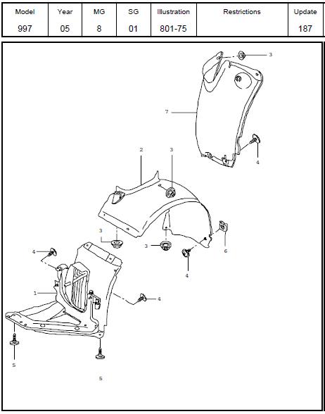

Here is a picture.
Part 7 is the rear.
Not a very big piece. Take the wheel off to get to it.
