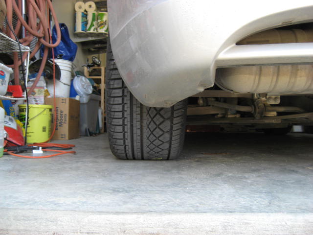

I just installed a pair of Continental Extreme contact DWS all seasons on the rears of my cayman. 275/35-19 at $220 a tire. I know it's frowned upon to install all season on a porsche but I do not track my car yet. I wanted a tire that had a little longer tread life. Once the fronts wear out I'll probably install the same tire in the front. After they wear out I will go back to my PS2 or RE11.

I am going to be upgrading to 19" sport design wheels this summer and had seen these tires on tirerack as immediatly noticed the long treadwear rating. They are too new to have any customer reviews on their site as of yet, so how do you like them? is road noise okay? does the funky tread pattern look funny when viewing the car from behind? Any input would be great, I am debating between these all season ones or the Extreme contact DW summers...

danieldolin, I literally just installed these tires yesterday on my sport design 19". So far I have driven 40 miles and I find that road noise is lower than the PS2's but the PS2's are close to end of life. Comfort I would say the same maybe a bit more comfortable in the ContiextDWS. If somebody installed these tires and didn't tell me, I don't think I would notice any difference in responsiveness or handling, especially since they are only installed on the rears. During turns I do not notice the rear of the car being mushy or any weak sidewalls, then again its not like I'm doing any autocross type driving on the streets. Overall so far I'm satisfied. I took a picture of the tire from behind. I kind of like the aggressive nature of the pattern. We get occasional snow here in KC so that and the 540 treadwear rating sold me on the DWS's.

did you go with 275x35x19 for the size... I do not think they come in the 265x35x19 that were OEM?

Yes I did go with 275/35-19. No issues at all. Install for the two tires was only $36.00 and done in 20 mins. Painless.
great to know... just wanted to make sure I did not need the 5mm spacers to make the 275's work... although I may still install the spacers to give a little wider stance.

So are you still liking the DWS's on your Cayman? If you would not mind, can you post a pic of the front view of your rear sport designs with the tires on as well as the 3/4 view? One thing that I was never a real fan of on the sport designs is that they always seemed to "stretch" the sidewall of the tire to make it look as if the tire actually went inwards from the outside of the rim up to the tread instead of having a slight "bulge" where the sidewall actually sticks out further than the rim. I was wondering if the extra width on the 275 tires would give the "bulge" effect I would be after.
