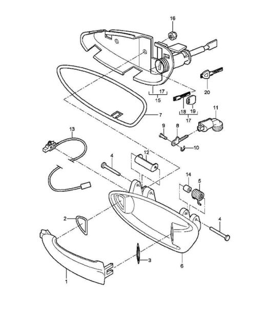

The micro-switch part number is 99761312501 and I
have included a picture with this.
Thanks for any help. I am looking forward to posting a
DIY when I replace this part.
Paul
The micro switch replacement requires a complete removal of the inner door trim, remove the bolts of the black metal inner door plate,(which is the inner door components carrier) with the window down. Pull the plate (carrier) backwards, as far as possible, and use the available room to replace the sensor. I'm sure you wish it was a 996.
