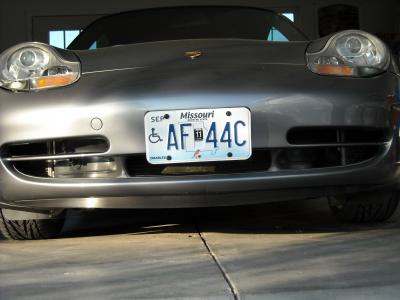

2001 996 C2, Tip, Factory option 7.5X18 with 225/40s on front (rim seems narrow for tire size) and 265/35s on 10X18s rear, freshly balanced. Above 80MPH steering feels skittish, wandering, floaty, loose, etc. Lots of slight steering input needed. @ 120MPH made me nervous. Is it just me or does the C2 have a nervous front end? I expected it to handle very reasuringly and feel steady at that speed. Just moved up from a suspension mod'ed 06 Mustang GT which I routinely ran up to 120+ very smoothly. Do I just need an adjustment period from a front to a rear engine car? I definately FEEL more steering input from the front tires. ANY insight appreciated.

At those speeds, you will want more front downforce as well - for your comfort level, at least get a GT3 spoiler lip or swap out the entire front bumper cover for a GT3 or aftermarket bumper cover.
