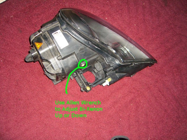

Prior to my ownership, the vehicle received a cooling pipe upgrade at the dealer via warranty and I hope I am good to go although one issue surfaced last night having to do with the HID headlights. Several drivers in front of me were holding up their hands to their rear view mirrors to block my low beam headlights. I verified it myself by driving in front the Cayenne and sure enough...both sides are too high. They appear to operate correctly as witnessed by the level changes seen upon power up and in the course of driving. I read the manual and found where/how to adjust the level but I do not have the proper tool to accomplish the task. I can sorta fit a flat blade screw driver but am not able to positively turn the plastic allen bolt (I do not want to strip it).
Question: is the adjustment for halogen or bi-zenon lamps OR both?

Here is a followup on the glaring headlight issue.
I went into the Walnut Creek Porsche Dealer. The advisor informed me that the headlight aim was not adjustable as he stated on the phone...I was really hoping to get someone different as I was 98% sure they guy didnt know what he was talking about. I asked him to obtain higher authority...The service manager cam out and said that his car has the same issue as well...he stated "they all have this issue and they cannot be adjusted because they auto level". Very disappointing. I plan to write a letter to the owner after I get their names explaining the situation.
In any event, here is a picture that shows how/where to adjust or compensate or adjust for headlight beam height. The procedure is mostly trial and error till you get the hang of how many turns it takes to alter the angle (2 complete turns is very noticeable). You do not have to remove the assembly all the way...just slide it out far enough to access the plastic adjustment screw.
I would expect each side to be a mirror image (turning to the right for driver assembly is the same as turning to the left for the passenger assembly). If anyone could verify this, the picture would be complete.

Great info - my recently acquired 2006 V6 Cayenne just failed it's ministry test today on one low headlight adjustment!
The handbook says as they are self-levelling it has to go to the Porsche Dealer, so I was very pleased to see this post and do it myself in 5 mins!
