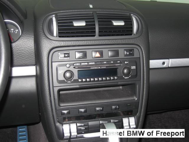

Can anyone please help me in knowing what parts are required to upgrade a 2004 Cayenne with to the Sat/Navigation PCM system? I would like replace the base BOSE CDR-223 radio unit.
Thanks in advance. I just picked up a 2004 Cayenne S.
