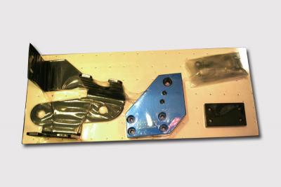

B&M Part # 45183 on sale for $75 Click Here
They also carry the GT2 and GT3 incarnations...
Edited by dynemd
The ability to misalign the shifter cables and the adjustment set screw on the shifter itself during install IMO is pretty high, which why I think some folks says it notchy, while others like me think its perfect. JMHO
